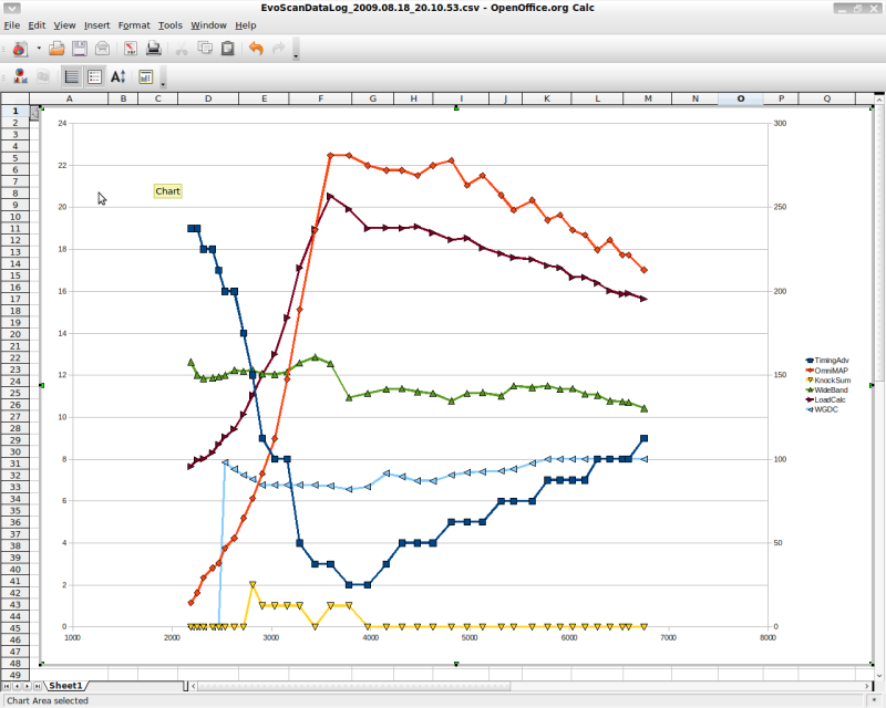

So here's a question. If WGDC can't be greater than 100%, how do you eliminate massive taper when you're already maxing the wastegate? Here is a log I took tonight:

u can get a 3port bcs - that will hold a bit more boost up top..

Surely there must be a way without that. I mean, here Mr.Fred is running on the stock boost solenoid and his boost is tapering a lot less (in fact this is really the profile I'm looking for as well).

mrfred runs a funky pill setup...
i dont know the specifics, but 3port will produce the same if not better result..
