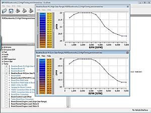

<table name="Base Boost #1 (High Gear Range)" category="Turbo" address="44f8" type="2D" level="1" scaling="psia8">
<table name="RPM" address="6982" elements="16" type="Y Axis" scaling="RPM"/>
</table>
<table name="Base Boost #4 (Low Gear Range)" category="Turbo" address="453a" type="2D" level="1" scaling="psia8">
</table>
MFRED, can you help in explaining more about the high gear range, and the low gear range.
Issue I am having is that gear 1-3 is reading on the high gear tables, and then 4-5 runs on the low gear tables. I see 22psi on the 1-3, and see 20 psi in 4-5, all at wot throttle to see what the boost guage and logs are showing.
Is there a chance that these tables are reversed? This is identical to what I have in my ROMID.xml. one additional note, I still have my orig. boost tables, BDEL 1-4. They read the same as the new baseline tables... not sure what to make of it, so must be confused about the language on the titles. Thanks in advance, and I am very greatful for your knowledge.
</table>
</table>
Below are my 22 lbs. boost tables. I am back on my lower settings due to the crappy Utotion gas. I really am confused about the naming of the tables. As I learn to tune myself here, and listening to you guys, I am hungup on the high gear and low gear settings. Low gear would make sence of the 1st thru 3rd gear, but it is actually the 4th and 5th gear settings. It seems the tables are reversed unless I am misunderstanding something?
Should I swap them? Should I make them equal?
Sounds like a rediculous question I know, but I would think you would want higher boost the faster the RPM. Can you straighten me out?
