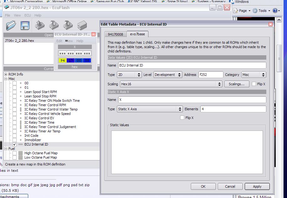

I'm not quite sure I understand the EcuFlash obtained ID as well.
Interestingly, my ROM ID, first recognized as 96420008 with v1.29 and earlier but now is 96420007 with newer versions, is strikingly similar to the lable on the ECU itself which reads:
MN191022
E6T3488XXX
46020008
Anyone know where the ID's came from?
Is it Mitsubishi or Colby manufactured (the ID not the code)?

Mine is here...MJ posted how to do this a while back.
Attached Thumbnails PATCH: NLTS + Valet + KnockCEL-ecuid.png
