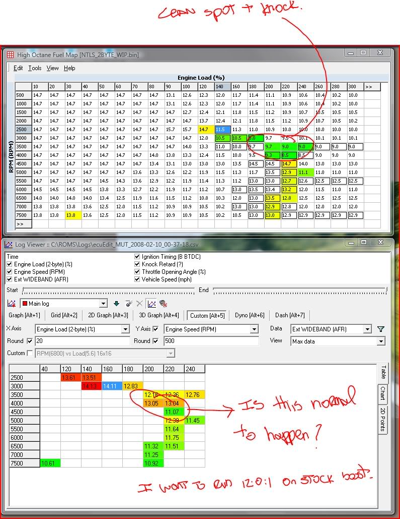

I see a delay in response between logged channels of about 0.3 seconds for WB.
How to tune an evo:
Minimum advance for best torque.
However, 93 octane or lower makes this difficult
where do you see the delay? I cant make it out.
also, I guess the delay will happen with all WB and its normal ?
LEANSPOOL = the ECU leans the mixture from spool to redline?
how does this make tunning more difficult?

The WBO2 delay has a little bit to do with the combustion and exhaust process itself, but likely more to do with compiling multiple data sources (likely running at different speeds/rates) in to one file. Depending on the order and number of the items you are logging, the delay may change slightly.
The delay is prominent during spool up when you jump across load cells very quickly. Your log may show 13:1 @ 260 load, when the 13:1 is really coming from the 180 load cell. So, you richen the 260 cell based on the log which causes a rich area after the lean spot.
Lean spool leans the actual mix in comparison to the map. So, a 10 in the map at 2500 gives the same result as a 9 in the map at 3000. That part of it is just annoying, but disabling lean spool makes tuning fuel more logical and map smoothing easier.
The big issue is that lean spool is meant to lean the mix in a different amount depending on a few different factors ... gear (or engine load) seems to be one of them. So your AFR from say 3rd to 4th gear will change.
I've also seen odd occurrences in higher gears where AFRs will suddenly jump rich by a full point or so for no reason. Disabling lean spool got rid of this.
Can you see this happening in my log?

Not in the log, but in the images you've posted ... you've got 9's in the map but you're seeing 13's in the log in that area with a rich spot afterward, right?

so ill disable lean spool and run the log.. tune and then enable it and im done>

No, you don't re-enable lean spool ... if you tune fuel and then enable lean spool you'll run really lean through the mid range. Disable it and leave it off.
