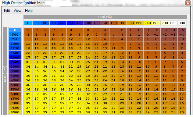

Anybody want to see a ****ty TOBZ Performance tune? I never recommend that anybody go to tobz in colorado for a tune. $300 for this garbage:
