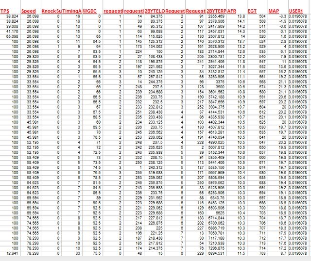

here's mines....mods are still TBE, 720cc, invidia o2, and last but not least #65 pill please all comments welcome...i'm still in the early stages of tuning for boost @ 23psi so it's conservative in timing and fuel, what do u think of the wgdc table for a 65 pill is it ok?. advice is greatly appreciated..o almost forgot it's 91octane

here's another log with lower boost/load on 3rd gear...the previous pulls were incomplete
Why so rich?
1* at peak torque?

originally @ 4...but when i started playing around with the wgdc #'s i lowered it as a precautionary playing with 91octane. maybe too much huh?

Some cars you can only run 1*, mainly depending on boost. I would start leaning out your AFR and see how the car reacts, then start fine tuning the ign timing.
Looks like you right on track so far.
You should be able to run some more boost as well, 20-21psi is just starting on the 9's.
thanks for the comment...i've read one of your threads on socalevo regarding the gains in boost vs. timing and was leaning towards boost instead. do you think i should aim for higher boost eg:24psi or more timing with my 65 pill i don't think i can go too far cuz it's almost maxed out.
