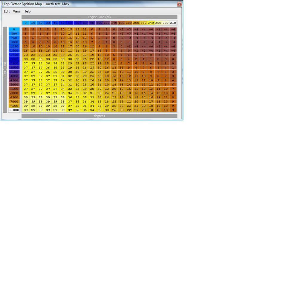

my meth map 27psi

Here's mine- ready for some critique.
That's not bad at all...
How's she run?
-E
Old Apr 8, 2009 | 03:54 PM
  #456
lan_evo_mr9's Avatar
Joined: Feb 2006
Posts: 1,097
From: MD
Like a bat outa hell! No knock what so ever. When I started this timing map, I would only get 1 count, at most 2 counts at the highest load at around 4kish. I was trying to run 7-8 at high load but it didn't work. Hence the lower timing in those areas. It's pretty cool to look at the log and see 7100 rpm with 19 degrees of timing at 24 psi with no knock. Gotta love the E85.

heres what Im workin w/...
pump gas (91) 24.5 @ peak - 21 by 7000
my work in progress... Ive Had a huge leak @ my DP, hoping to have that taken care of tomorrow, so I can get back at it.
input always welcomed!
