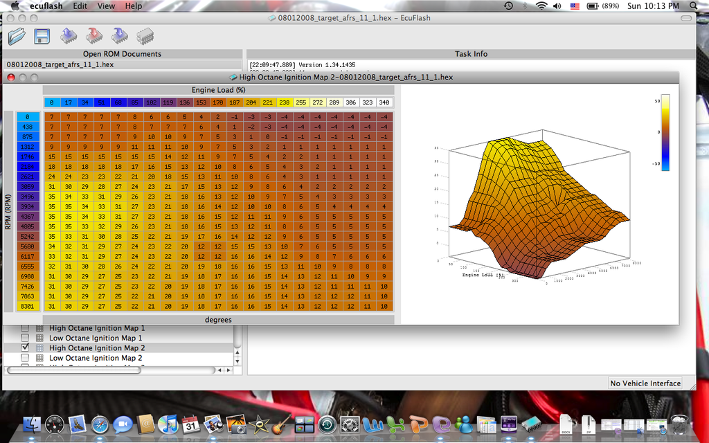

tubular BR3065
cossie m2 cams
BR Race core fmic (recently installed)
Nisei piping
780s
IKH24s
catless 3" with Invidia G200
5 degrees on peak boost around 4800rpm (22-24psi)
13 degrees until 7800-8000rpm rev limiter
However i have to lean the car a little bit. I am running way too rich right now. I like rich during full boost but i have to lean out around 11.2-11.3 up top because now i am running 10.5-10.7s... Hopefully it will losen up a little bit and probably make more power...
In the coming weekends i will try the same map by adding 2-3 degrees of timing, 2-3psi more boost using Torco (i always have a drum sitting around)...

If I were you i'd go even leaner than 11.3
I used to have 10.5 afr (before i installed my wb). I had already tuned my car to the edge timing wise. When i installed the wb, I leaned it out to 11.5-11.6... the good news is I didn't have to drop the timing at all
Old Sep 3, 2008 | 06:20 PM
  #430
kouzman's Avatar
Posts: 2,269
From: NYC
i am not a supporter on leaned out cars on pump gas...
on racegas yes, i would go even 12:1 but on pump low 11s... Couple of weeks ago i did a test on the dyno and from 11.8 to 11.4 i didnt see a difference in power... Obviously i selected the richer version of the map...
i am a fanatic supporter of the saying.....better run rich than sorry...
and dont forget... one tank of bad gas is enough to make the car knock like a jackhammer especially if you ar that lean...
