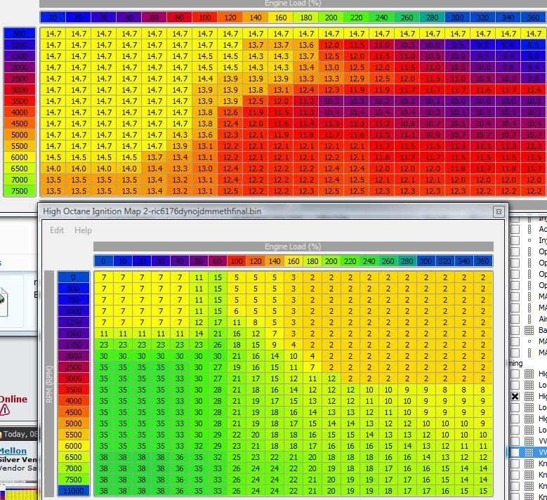

I forgot i had this in my photobucket...
Here is my 35ish cosi cams meth all bolt ons

Curious to know how much timing do you guys run transiting between vacuum and 3 to 5 PSI of boost....
Old Aug 29, 2008 | 09:59 AM
  #415
denver's Avatar
Joined: Oct 2006
Posts: 437
From: DFW, Tx
^Look at the load cells from 60 to about 120ish.... that is generally the the transition between vacuum and boost....

what does the differnt shades of colors mean
Old Aug 29, 2008 | 06:32 PM
  #418
kreionic's Avatar
Joined: Apr 2006
Posts: 2,258
From: MD/ NY
Just the color scheme of the tables. You can change the default colors in ecuflash. Nothing more than to make it look pretty.
