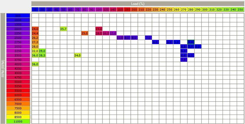

Hi, wanted to share my ignition map. That is 2,3l, stock evo9 turbo, kelford tx272, hitting 280-300 peak load depending on the gear at 25-26psi peak boost, 93 octane (98ron). No WOT knock, sporadic spool up knock.
Any input would be aprecciable.
Too much timing at low rpm, full boost IMO.
Raptord,
I'm still trying to learn here. So are you saying at full boost (Load 280) timing is too high? I'd agree with that. What about loads 100-120? It seems high to me.

Originally Posted by 10isace
Raptord,
Yep, from around 240-onwards or so, timing should be lower. I'd say 3° at 280/3500rpm.
100-120 might be a tad high as well, but not as alarmingly as high load.
The goal is to make the most torque in low to mid RPM.
Why do you consider it to be too high? As far as it makes power and doesnt knock...
Just because it doesn't knock doesn't mean it's perfectly safe. Your rods could be taking a beating from that much timing without it actually knocking.
6-8 degrees at peak torque is usually E85/race gas territory, not pump gas.
I don't think it has much room for high air temp, bad fuel. Your 93 seems good up there in Russia ... For street it's "acceptable" IMO.
A lot of people with US 93 run around 4* at peak, you are a little agressive.
Assuming he went further than MBT... but on pump gas?
