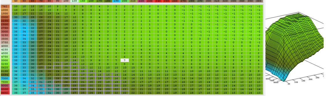

I know it's far from good map, still working on it and would like to hear suggestions
22-23 psi peaks at 290-310 load @ ~3.8-4 K rpm

Heres where I keep ending up. I have to pull so much spool timing or I just get a bazillion knock counts.
I still have a knock count at 3750-5k under light accell I cant get rid of.
Do yoou think my Skunk 2 ported intake manifold GSC s2 cams are bottlenecking from the stock exhaust manifold and causing low spool timing?
300 load down to 260 roughly 18 psi
Complete mod list?

Rats can we see a load trace please so we can follow through the map, and that colour scheme O.o

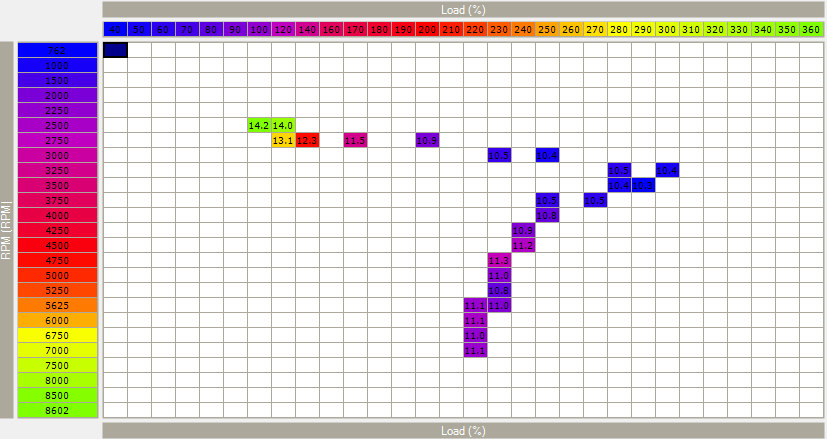

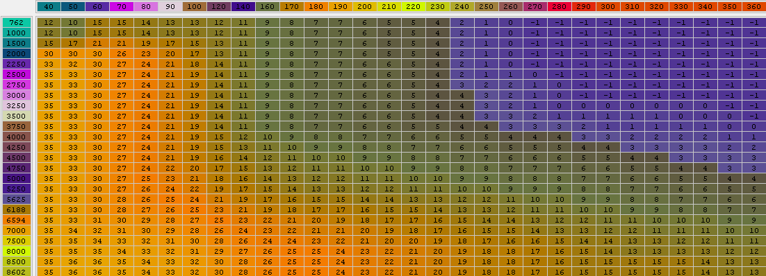

Ok, this is the upgraded timing map I put on late last night and tested this morning. Theres a map trace with my analog out from my AEM, the precision is leaving some to be desired IMHO there and finally the log.
Note the SD seems to be a little inconsistent with AFR's and we've had drastic weather changes here latley. I havent touched up the VE map

needs leaning out big time

I'm just happy to see timing map coincide with timing advance
Ill lean it out once I sweep up the 17-18 psi mark for timing. I've seriously been banging my head for a while.
