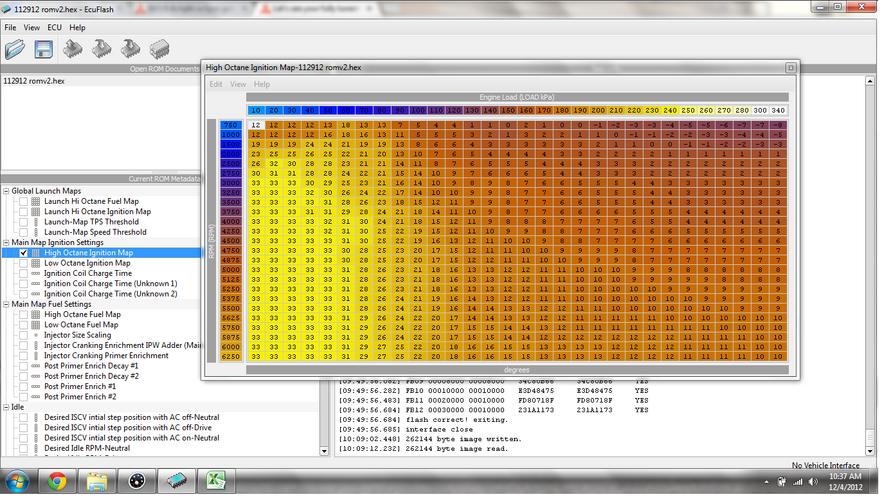

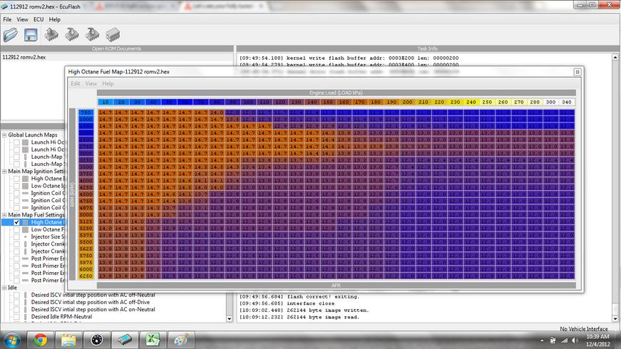

hey guys I've read and learned a lot on this forum and thread. I would like to share my progress with my evo turbo setup on my eclipse.
00 eclipse rs.
4g64 block with sohc. stock motor
evo8 turbo 9.5 (boost set at 12psi for now.)
3" TBE
stock evo8 intake pipe.
2.5" UICP & LICP
1g crushed BOV
evo8 injectors and fpr
walbro 255 pump
hallman MBC
aem wideband
so its kinda like a stock evo8 turbo setup.
here's my most recent maps
peak load is 289 at 4250rpm... kind of high??
at 6250 is at 220 load.
let me know what you guys think.

Old Dec 4, 2012 | 08:09 AM

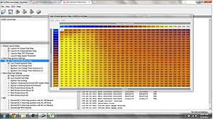

  #1950
Biggy VIII's Avatar
Joined: Nov 2008
Posts: 424
From: Russia, Moscow
Here is the map of Evo8 2.0 CR9 + Kelford 272 + lots of supporting mods + CBRD BBK Full ported. The car runs 25psi tapering to 23 at redline, making 470hp 530nm. BP RON98 pump gas. No knock at all. Road racing tune.
It is wierd, but peak load at this level of boost is 240. I traced it and marked the cells so you could see what timing does it run.
