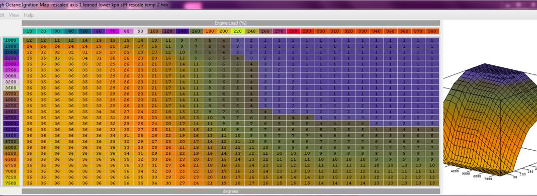

ive been working to establish trends in a clear manor . More experimenting. I'm pretty sure my spool timing is lacking a few degrees
s2 cams
skunk2 ported intake manifold
stock exhaust manifold
HTA 71 with 84 cover and intake tube
type s bov
jmfab intercooler
Im gonna work on getting the spool timing back in, rough 2-4 degrees
I thought I had more timing in there at peak load but im gonna work on that ramp! peak load at 3750 - 340 ish
7500 - 270ish

Originally Posted by 211ratsbud
Hey guys hows this look? 350-360 load @ 3750-4k down to 260-270 load by 7k
s2 cams
type s bov
jmfab intercooler
Looks good 211ratsbud. To me your spool area from 100 to 160 low RPM doesn't lack timing. You could try more, but what I can say is that my VIII starts to knock at even lower timing / 13-12.5-12.0 AFR.
