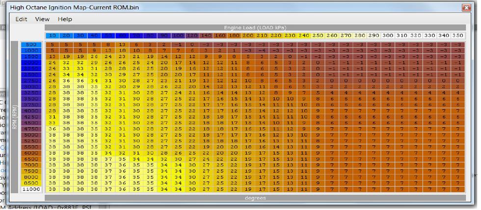

Hello, maybe this is the right thread to post. I've been battling with knocks for awhile. Back in Jan, I logged knocks as high as 12 while under load. Since then, I changed plug wires and to copper plugs gapped at .22 and reduced by half 1-6 counts. Recently, I upgraded my fuel pump/injectors and tried scale it best I can . I did some 3 pulls back2back, and now highest knock is 4. Just conversing with a respectable tuner, he believes I'm almost there. So I wanted to see if I can do this myself before going to the tuner. LOoking at my map, do I need to just reduce timing in knock cells and "smooth out" the surrounding areas? From my logs, anything I need to do AFR, etc?

Way too high timing at peak load!!! Try 2* at 3250 and 3500 and 11* up top. What are your AFR readings?

thats an interestingly high amount of timing to be running on 91.
True
Funny thing was a local tuner suggested I run that high on 91 too. Blew a HG.

Holy Shxx!!! ok, I'll try to work on it tonight and post it up. If it seems I'm clueless, please let me know and I go to reputable tuner. BTW the tuner who gave me advice didn't have my maps or logs...just based it of our conversation. I'm know I would've gave my logs, he would've said the same !
Which load should I start/end with the 2's and 11's?

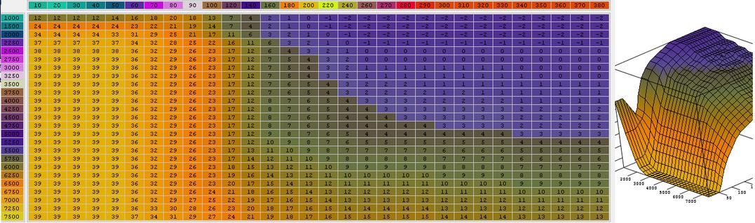

my 93 oct s2 cams map, also an IX

If you dont mind me asking but whats your boost like? Peak-tapering?

310 load 3500 260ish load 7k
19 creeping to 22 or more weather considered

Looks good!!! You've got a slight dip at 3750 300 load.

tuned for first(second too) gear needs that ..
My hta 71 is beginning to fail aswell. theres a fair amount of axial shaft play.

Ok looks good!
