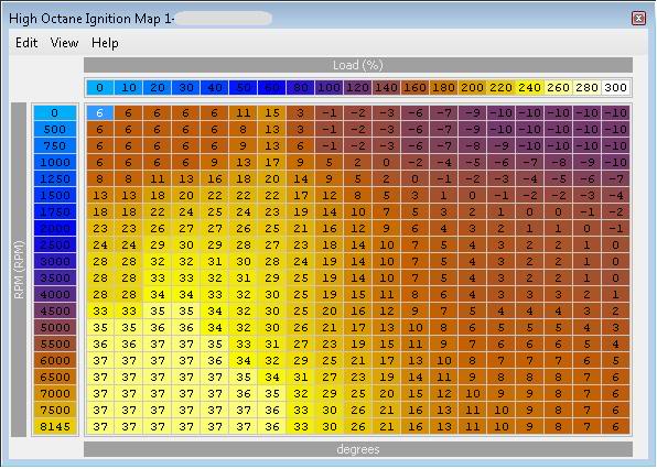

Here's a shot of my timing map. A big thanks to Appauldd for helping me fix my phantom knock issues, which in turn I was able to get an accurate tune and sort out my map.
For the guys who are looking around and trying their best to learn from this thread, this map is a 24psi spike dropping to 21 on a Hallman MBC. Other mods are Samco intake pipe and cone filter, Helix 272 cams, 880cc PTE injectors, IX turbo (ported), 3" downpipe, 3" exhaust, 3" test pipe, AMS licp, and ported aftermarket stainless O2 housing.
Straight Shell 91 octane in the socialist state of California.
Let me know what you pros think. Thanks for looking.

Looks ok to me. Cruise 10-60 could use some work

thanks Bryan. That area was where I was having most of my knock issues. Going to bump the timing up some and see how my car likes it.

Old Feb 22, 2010 | 05:34 AM
  #593
rolly1818's Avatar
Registered User
Joined: Nov 2007
Posts: 1,507
From: Trinidad
yup you could bump the timing a little...seems low, does the car feel lazy at all?
also the timing at idle is a little low

So I made some adjustments to the low load timing and the car seems a bit perkier. Nothing major. Let's see what the long term results are.

that cal 91 really holds it back eh ?
thats all that supposed to happen
you wont gain "power" like you want by bumping those timing values. did you try to bump a bit of timing at idle?

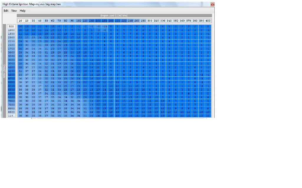

time to critize my map, just want to know what you guys think. my car reaches the 360 loads for now. My car is round 27 pounds of boost but i think I can add some timing up top. I had some issues with boost, but I took care of that so I am still adjusting the map. btw running 93oct ,sorry about the resolution
map needs alot of work.. with out a log its harder to see wat areas realy need help.. i have no idea what a hta 35 boost curve would look like so i cant even guess.

Save as a png so we can actually read it....
