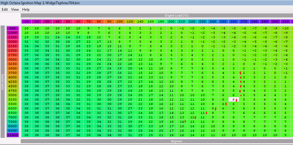

Yeh i had a similar issue with tip-in knock, no matter what i did couldnt remove it esp in lower gears like 1st and 2nd, i had to lower the Knock Sum decay timer and increase the knock load threshold in the lower rpms,
Here is my current map @26psi

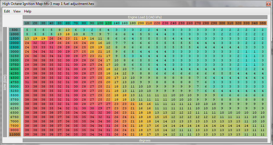

Here is mine. I am still experimenting on timing during spool and what not. Anyway...
Attached Thumbnails Let's see your fully tuned timing maps-timing.png   Let's see your fully tuned timing maps-timing-curve.jpg
the hell is with that block in the low load and higher rpm area?

lol I was playing with that at the drag strip. I found that when shifting my car would carry 38* timing all way into the 200+ load areas so I lowered it to match what it is normally at that point on my map at high load/rpm. I have it with only 38* in that section as well. So far I have not touched the 11 area except for at the track.
Looking at my map tracer it looks like I would have to change it in up a little to get rid of the rest of the high timing btwn gears. I am curious if it will help bring the boost back btwn gears.
