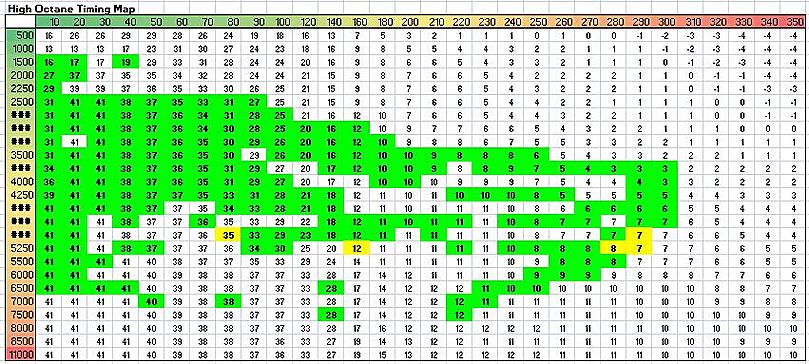

For better or worse, here's mine lol (self tuned, still working on it and learning).
As a side note, I use an unmodified JDM RS Mivec map.

Your timing seems to twitch between going up and going down. For example, in the 3500 rpm column, starting at 200 load: 6 5 4 5 5 4 4. There are other places where this happens. Timing should gradually decrease as load increases, and gradually increase as rpm increases.
Oops
Old Nov 1, 2010 | 06:11 PM
  #689
Raptord's Avatar
Joined: Mar 2009
Posts: 3,525
Likes: 20
Much better
