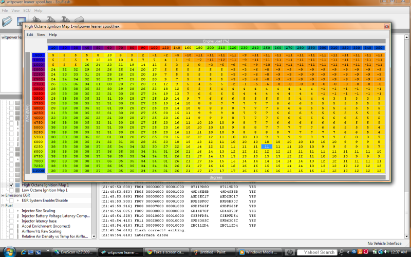

Let me know what you think. Its my first stab at this. Im running a green on stock injectors at 19lbs until I get injectors. The idc's are in the 80s. I am having trouble building boost until VERY late.

Looks decent to me, nice and smooth. How much load are you seeing through the rpm range?
boost is more likely your duty settings or a bad actuator/solenoid and/or vacuum hosing. or the worst scenario a boost leak

im on an mbc, im going to see what a boost leak test tells me. I typically see 260 load.
