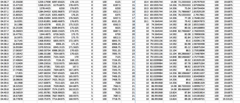

Stock map officially loaded and logged, i was too scared to log that other map from the looks of everyones opinion. So heres the log.
Attached Thumbnails Let's see your fully tuned timing maps-datalog1.jpg   Let's see your fully tuned timing maps-datalog2.jpg   Let's see your fully tuned timing maps-datalog3.jpg   Let's see your fully tuned timing maps-starting-point.jpg   Let's see your fully tuned timing maps-screen-shot-2013-05-08-8.19.34-pm.jpg

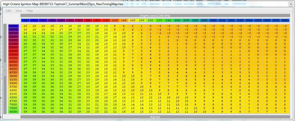

Heres mine I feel like it could better

Steven, I would try to smooth out the 7000+/230 load values a little. You're jumping 3* in spots which isn't recommended at that high RPM/load intersection. If you don't rev to 9k, you can rescale your left axis to give you a little more room, say 7250, 7750, 8000, 8500 or something. Try to smooth it to 1* increments in those areas.

Here is my Timing Map. Maybe somebody can see some faults....
I'm driving on 98 Octane. FP White with 25.8 PSI (1.78 bar) peak tappering down to 21.1 PSI (1.46 bar)

timing goes down then up in the low rpm ranges, maybe its not a range that is normally hit?

@ 211ratsbud

310 load 4250 rpm

310 load 4250 rpm
Great! Thank you. Normaly i dont reach load over 300.
