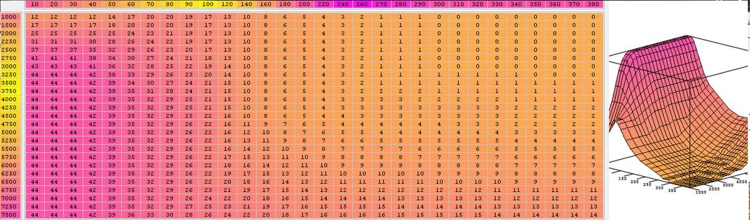

so this is my current get up and go map.
peaks 300 load @ 3600 and drops to about 265 by 7000.

Hi, i am new to ECU flash , a couple of questions if any one can guide me.
I have load limit till 260 in my hi octane fuel map, i am controlling boost with a manual boost controller. Is this load actually referring to boost ? if so 100 load = 1 bar boost approx or otherwise ?
Why we need to increase load cells to 280 or 300 ?
For pops and bangs one needs to retard timing as stated earlier in this thread. What if i dont want pops and bangs , i just want flames when i let off the throttle to shift gear what should be order ?
Thanks.
Thanks.
100 load is roughly equal to the threshold between vacuum and boost.
Load is a function of air going past the MAF. So with a larger turbo and/or more boost you have more airflow, therefore higher load. That's why many need to increase the max load in the timing and fuel maps.
If i change the turbo , how would i know the car needs more load cells ? Will it hit a boost cut because the required load cells/ load range wasnt defined in the map ?
Old May 24, 2013 | 06:33 PM
  #2280
211Ratsbud's Avatar
Joined: Oct 2010
Posts: 4,286
Likes: 43
From: Watertown, NY
If your logged load exceed the load axis then it's time to rescale or not move as much air.
