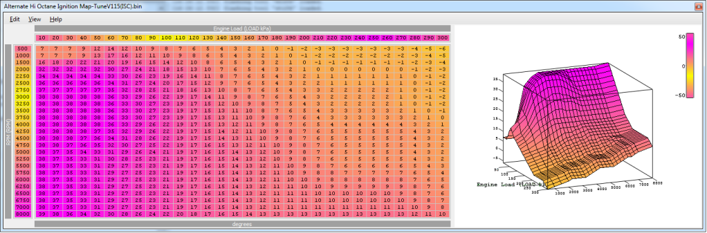

Hey Guys,
Here's my first map. It's FAR from fully tuned. I just spent some time scaling it to suit my car for right now. There were some goofy little sections where timing went up and down. I smoothed things out the best I could. I'm hoping to do some logging this weekend and actually make a few changes. Let me know if I did anything stupid.
Again, this is a stock Tephra V7 Evo 8 map scaled, interpolated, and smoothed out.
