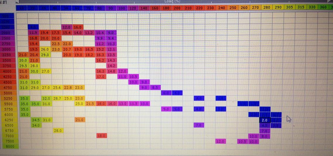

Originally Posted by 01sporty
2.4lr 91 octane 31psi hx35/12cm housing this map ran me 12.0@120 at 5500 elevation in Utah. No knock (occasional 1 count) 11.2 at peak boost afr going to 11.6 at Max rpm
443hp pump gas/ 427 tq spool up is around 4k full boost
Load value on speed density peak tq= 315 load taper to 290 by 8k
What's happening to midrange timing ? You can't get it higher? It's really mild at 315 load until 6000RPM.
It's an odd map, timing numbers that make sense are starting at 7000RPM.

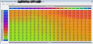

This should have fixed everything....
Last impressions?
Btw, thanks for the feedback! I'd not be too happy if It shot a rod out haha.
Last impressions?
Much better!
Try my smoothing tool to solve some minor rollercoaster issues: https://www.evolutionm.net/forums/ec...t-version.html It's for bigmaps, but with proper copy paste you can use it with small maps. You can use it only to search and find the odd timing numbers.

Here you go

From: salt lake city utah
Mid timing kept low for two reasons ****ty fuel and helps spool up

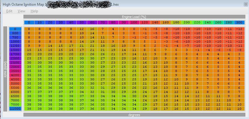

Originally Posted by domyz
Much better!
Well, Here's what it did...Top = Before. Bottom = After
Attached Thumbnails Let's see your fully tuned timing maps-timing3smoothed.jpg
See post above
Use 200Load-1750RPM To 300Load-11000RPM (copy paste)
It has made your map smoother in that area while solving the up and down and up timing issues.
See post above
Low cruise timing. This leads to bad MPG.
Low tip-in timing. Maybe it spool faster, but that surely isn't snappy.
However it's a nice 91 octane number (443whp).
