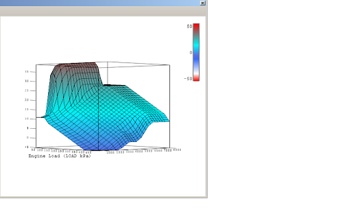

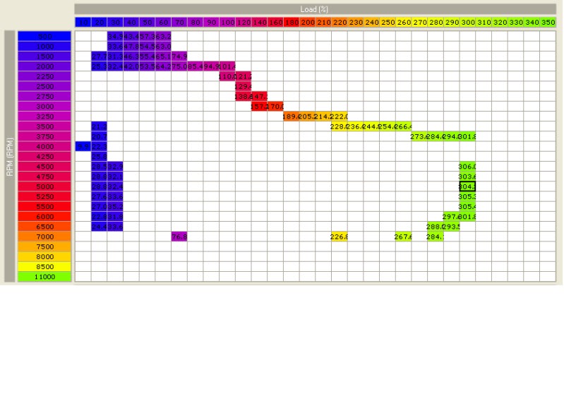

b16a2delsol's Avatar
Posts: 338
From: killa streets of slc
Works for 18 psi and 27psi to redline on a hta green on 91
Its getting there.
Kinda choppy map there. Might wanna smooth it out between 120-140 for smoother spool up.
Spool up does need some smoothing, but the rest of the map is "choppy" because thats how it logs, and thats where I tune from. I could make it pretty but that doesn't mean power or safe. This map works great as a base map.

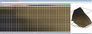

maplemaf's Avatar
Joined: Jun 2009
Posts: 41
From: quebec
what do you think of my map oct91(quebec) 3"catback 3"downpipe piping injen 24psi evo9
final.png?t=1305480169

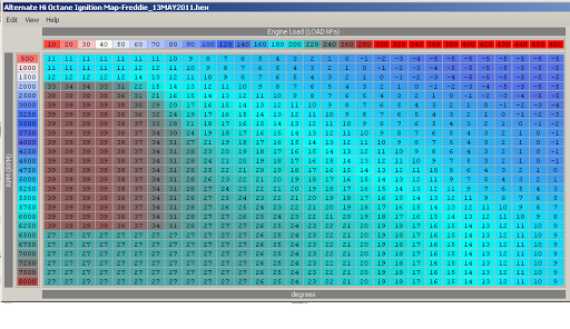

Here is my 2.4L on E85...
Doesn't look bad, got any logs? PM me if you want any help, I'm in Quebec as well!

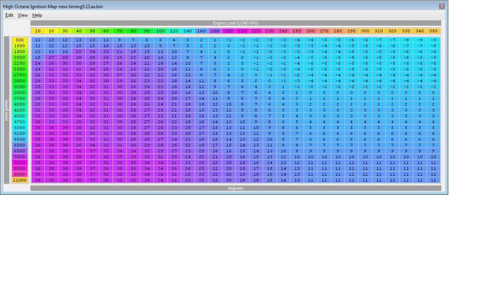

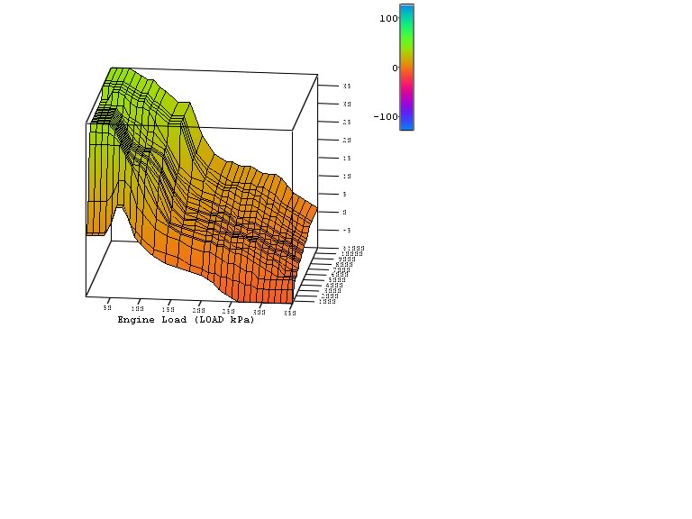

Another update from my end.
evo ix
hks 272 93 oct, buschur dp, ported ebay o2 housing, pte 100cc injectors touches 300 load tapering to 210-220ish by redline on 93 oct. I seem to have to run a very little amount of timing at peak load, is this normal for a mivec IX? i usually hit -2 @ 25-26 psi. Is the stock intercooler not up to par here?
Attached Thumbnails Let's see your fully tuned timing maps-new-timing-map.png
