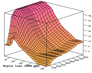

The excel files are a good start to getting your maps smoothed out, but for optimal results you need to spend some time doing it manually afterwards
Here's how my graph looks, I won't post my map since it's originally based on a tune by tscompusa (unless you dont mind Tom)

Yeah for me I helped because I have an easier time having it start smooth and then just keep my changes smooth, smoothing a chunky map was becoming way too overwhelming an I was winding up with values I didn't want to be using in important areas.
I also likethat the sheet shows you the change between two maps so I could track how many degrees I was adding.
