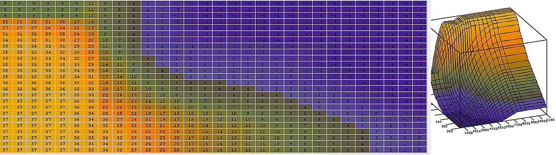

This is what I've been going with lately.

Can you guys comment on the general shape of my map? That is something I have been focusing on to try to understand necessary timing changes even though it does run alright .

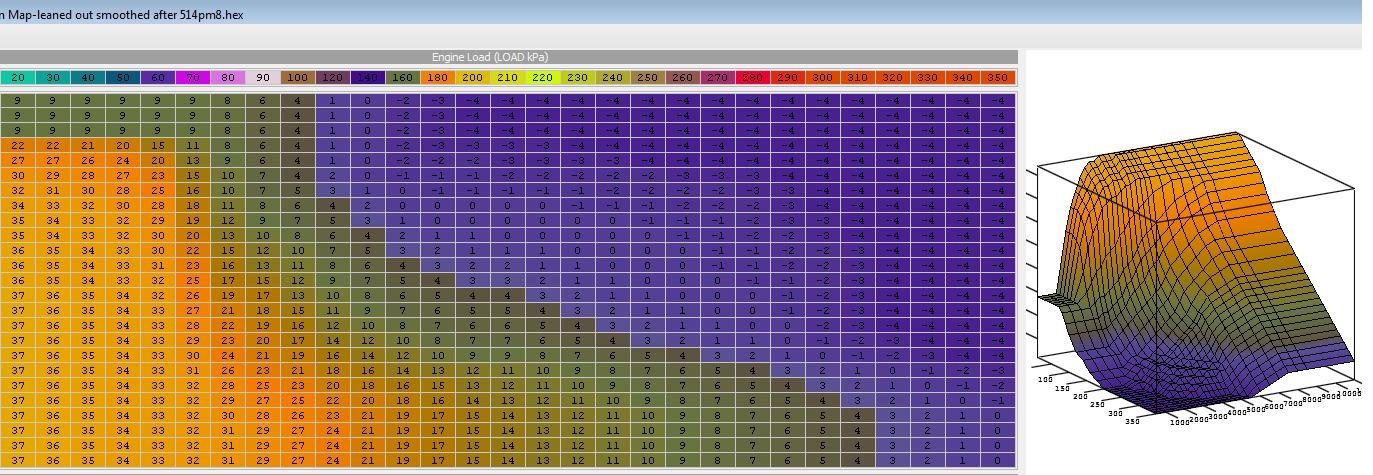

Yes hks 272s. I started pulling timing in the medium load ranges, and I'm getting some bad spikes of knock on lift . Don't understand what caused the lift knock, I'm not speaking lean. And that timing works when accelerating
This one works significantly better. Im really getting suprised how little timing this really does take.
still taking my time tuning the fuel tables aswell. Im having a hard time to get them above 11 lol..

why are you running so rich and such little timing at peak torque? youve got quite a bit of power left with a more aggressive tune for sure. PM me if you would like a little more help on the tune

I'd say your running so little timing its pre-igniting like crazy. You need to up the timing pretty significantly.
No reason for the car to see any negative timing under boost IMO, that timing map definitely needs quite a bit of work. Fueling as well, Your AFR is in the 10's at only 5psi when it should be in the high 12's.
