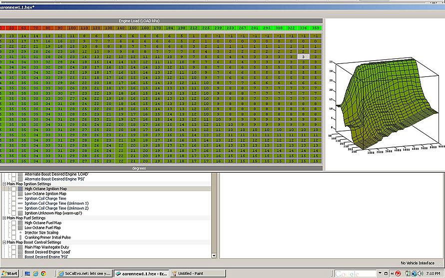

ok so here is my first atempt at a e85 map. this is based off my 91octane map and i have not yet run this on my car, i want some opinions first!
https://www.evolutionm.net/forums/at...85newigmap.jpg
any more help on this would be great

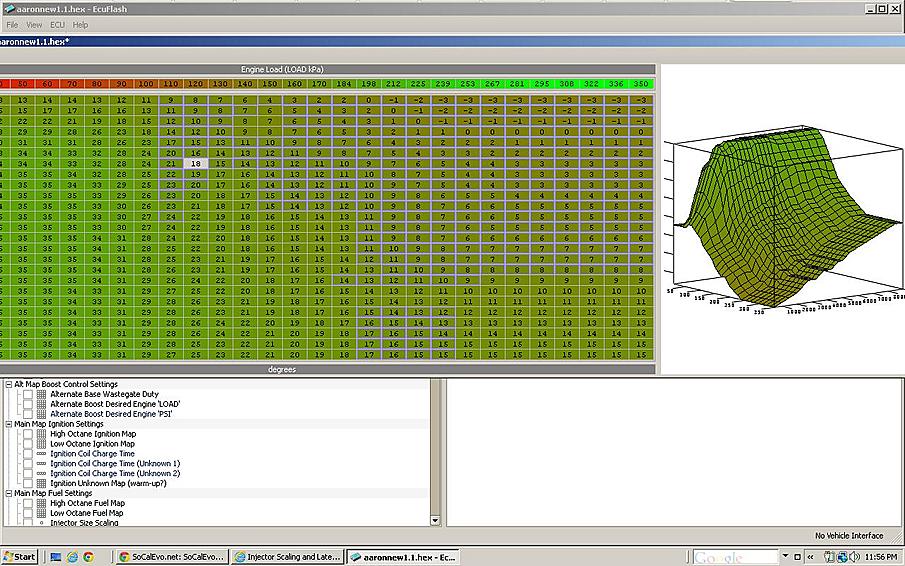

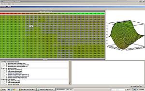

e85 edit
ok so touched it up some opinion???

please any comments on post 1087 i am going to go fill up on e85 soon and just want to make sure i am starting off in the right place? also what changes should i expect to make to the fueling map? i think i want to be around 12.0 arf on it yes? thank you all for the help
