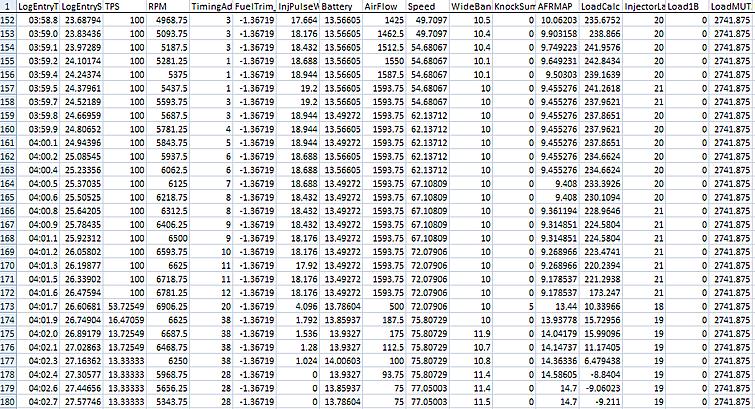

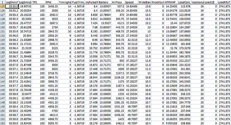

So I decided I would get my feet wet and start tuning a little bit before I have money for injectors and a professional e85 tune... read up on how to tune an evo and merlins ecuflash guide...
attached is a jpeg of the log in excel and a jpeg of the new timing map... let me know what you think of the timing map before i go blow myself up!
05 MR with catless TBE, drop in filter, walbro, licp, mbc set to 21 psi
not much knock on the stock tune...
logged on a flat road and was at about 270-290hp and 240-260 tq on VD (all 3 logs were different on the EXACT same section of road... but they were one after another within the same 5 minute time period so that could be why?)
Attached Thumbnails Let's see your fully tuned timing maps-newmap.jpg   Let's see your fully tuned timing maps-logpart1.bmp   Let's see your fully tuned timing maps-logpart2.bmp

You're running quite a bit richer than you need to Taylor, you can lean it out to mid-low 11's; no reason to see 10's at any time. I would start with getting the fuel at least out of the 10's before playing around with timing, as just leaning it out will add power.

thanks raptord! so I should tune the AFRs before messing with timing?
I figured it would be best to fix the AFRs first but I had read that it's best to do the afrs last...but I see why in this case its better to do the AFRs first since they are so damn rich..
I've been using excel to calculate the AFRs. I think I'm gonna try and figure out how to use logworks. When I used the maptracer in evoscan it didn't really work well
Also: when I try to log mut load 2byte and load 1 byte it doesnt work... is it ok that I'm only logging calculated load?
Should I ditch the timing changes and try flashing the car with just the AFRs I posted?

Generally you should adjust timing first, and then A/F later. With the stock intercooler you will probably get heat soaked fairly quickly if you're doing a bunch of back to back pulls.
I log calculated load, and don't really have much trouble. Make sure that you are changing the values to the left and to the right of what evoscan logs. That way you will get more consistent results if you're fluctuating between load cells.
Make sure that when you are doing your pulls, that you do them on the same stretch of road preferably going the same direction to aid consistency. You want to make sure that you're changes are related to your tune not the road.
I like to do like three or four back to back pulls to make sure that even if the intercooler is getting heat soaked, it's not knocking like crazy.

Yes, usually you do timing first, but since your AFR's are so far out of the "normal" range I'd recommend getting them at least in the ballpark before messing with other things.
1Byte load is only available if you're using a TephraMod, and to use 2Byte you need to make changes to your MUT table first, so that's why they aren't working. IIRC 2Byte load would be more accurate than calculated load, so you might want to configure 2Byte load and see if there's any discrepancy between 2Byte and loadcalc.
Also, I forgot to mention this in my first reply to you, but you're logging more things than you need to in evoscan, which is slowing down the number of samples per second you're getting. Only log what you need.

Timing should be done after fuel as the AFR affects the flame front speed and the flame front speed determines the timing.
