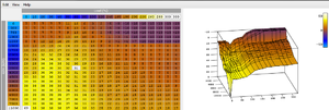

Here is my car's timing map. Now before there is war, my car for some reason does not like more timing, I hit 300-310 load at about 3500 rpm and if I give it more timing she starts knocking.
3" TBE
Invidia dump
255 Walbro
LICP
Drop in K&N
Grimspeed 3-port
The car is pig rich, boost spikes at 26-27psi drop off to 24-25, stock E9 turbo. Rev limiter is set at 7000 rpm at which point she takes only 9* of timing. The way it is set now there is some sporadic 1 count knocks but they are definitely phantom as they appear in different places during different logs. Fuel is 98 RON (suppose to be). My High Octane map looks more like a Low Octane map to me!!
Your thoughts??

I have a hard time believing that your car can't take more than -5 degrees at 3500 rpm. How rich is it running?
I have not tuned the fuel yet 'cuase I am still waiting on my LC-1 to arrive. As soon as I have wideband I will be able to get the AFR's sorted which should allow me to give it more timing.
This is how I got the tune when I bought the car.
You really need to get a wideband hooked up before you do anymore tuning. There's about a 99% chance that you are not hitting the numbers in your fuel map and the only way to know what the car is actually running is with a wideband.
