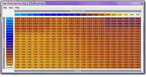

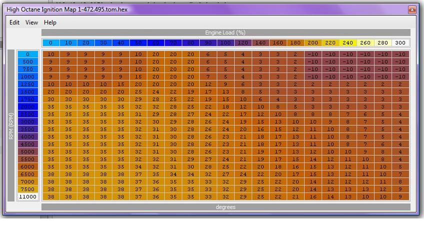

Hello. Can somebody say something about my map?

What kind of fuel do you run? It's definitely a bit messy...Could use a good bit of smoothing...It shouldn't be aggressive like that then drop 3-4 degrees in the last column...

I am running euro 99 oct Shell V power Racing only. Mods in my sig, boost 24 psi -> 23 psi@redline

99 oct...Your lucky to have that over there...Do you have any logs from Evoscan you can post?
