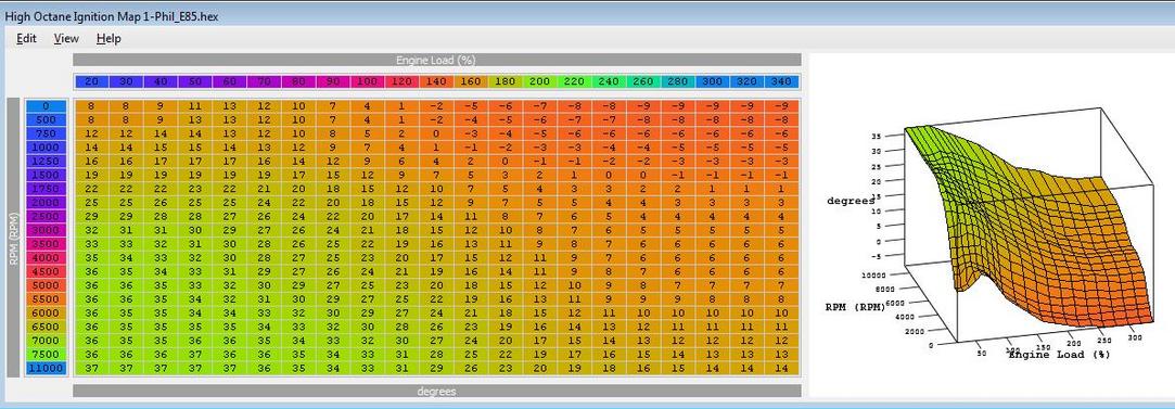

anyone wanna throw out some input bout the map? Always open to hear outside opinions.
Here's this to go with it..
Looks pretty good to me, as long as your not over MBT. The only thing I would do personally is rescale the RPM axis and take out some of the lower rpm values and add some more rpm values uptop for more resolution. But thats just me.

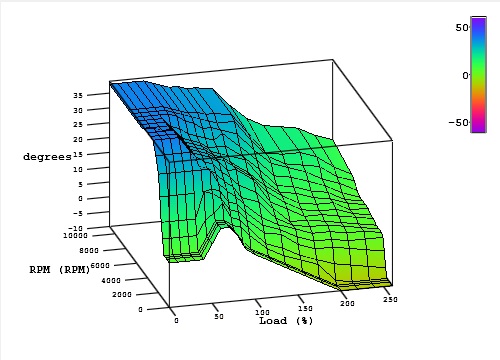

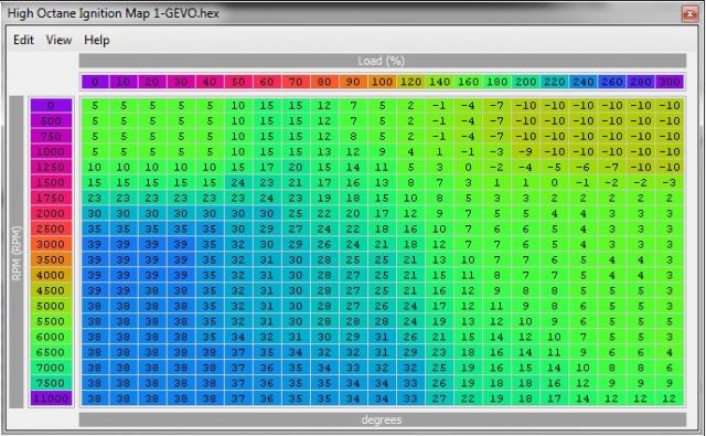

Dyno thread https://www.evolutionm.net/forums/ev...gear-pull.html
Attached Thumbnails Let's see your fully tuned timing maps-fpgreen-timing-1-.gif   Let's see your fully tuned timing maps-fpgreen-timing-2-.gif
I would back it down a hair up top.. Usually you want 7-7500 area at 15-17*.

Originally Posted by Biggy VIII
Are you sure you are in ned of 6* at peak tq area? U should bring that down to 3-4* and see if the power changes a lot.
ON another side up top your timing looks nice.
