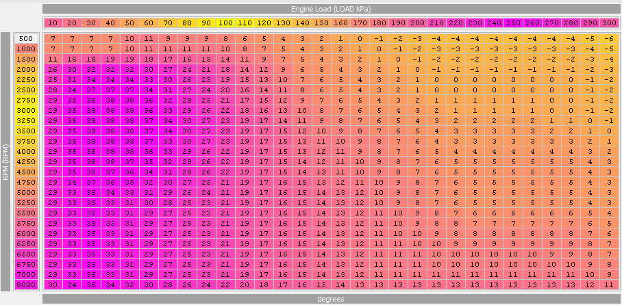

Timing map

SD tuned, Hitting 270 load @ 3250, to 250 at 7400. Not much taper because I run flat 24psi (modded stock catback but still restrictive ; 3" CBE in fabrication right now)

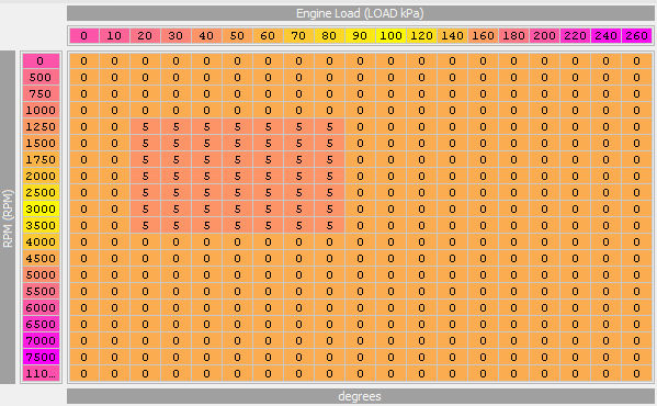

EGR
