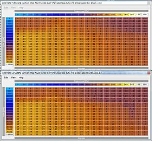

Do they look like that bad?

That looks fine mavraolan. One thing you may want to double check is the high-load area of the low octane map. Your timing goes 4 -6 0 at one point instead of smoothly going down from left to right.
Thx buddy. I use Big Maps smoothing tool and I smooth both of the maps so I believe that area is been fixed.
That tool smooth's but also retard the timing. If you think that those maps are fine now, I could make some log and then advance it little.
Which area do I have to advance for low end power/TQ?
Old Apr 9, 2014 | 12:58 PM
  #2518
Raptord's Avatar
Joined: Mar 2009
Posts: 3,525
Likes: 20
What does your load curve look like? At a quick glance your timing seems good already. And what fuel are you using?
Not sure how to log load curve but I will try on weekend ( if you could pm me how to do it I would appreciate it)
I am using 98. Is like 93 in US though I believe but not that good gaz.
Old Apr 9, 2014 | 02:04 PM
  #2520
Raptord's Avatar
Joined: Mar 2009
Posts: 3,525
Likes: 20
I just mean what peak load you are reaching and at what rpm, and what it tappers to at 7k rpm.
