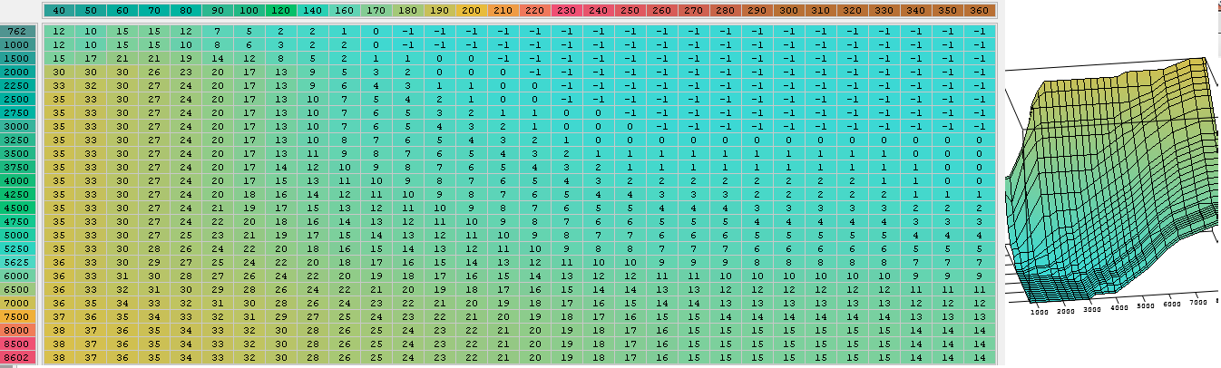

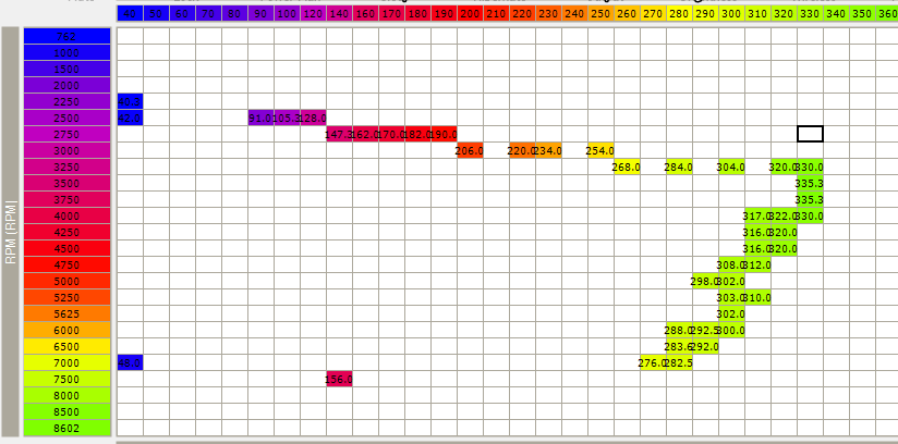

This is the closest bestest I feel Ive done so far. 22 psi peak about 20 out the top.
Going to reload my WGA a little bit to 20 instead of 14 for my FP 18psi wga, and give ecu boost a little better shot at holding boost up top. right now 100wgdc gives me 23 up top, and Im looking to hold 25 or better with a lightly convex boost curve with about 28 midrange. The Skunk 2 STM ported mani and GSC s2 cams need a little wind to make them operate fully I believe.
Attached Thumbnails Let's see your fully tuned timing maps-tmp.jpg   Let's see your fully tuned timing maps-tr.png
Old Aug 26, 2012 | 05:04 PM
  #1760
Toxin's Avatar
Joined: Jan 2008
Posts: 1,595
From: Way ahead...
From what your maptrace shows, you're actually hitting negative timing cells during a normal pull? You're robbing yourself of quite a bit of torque and causing some seriously high EGT's...

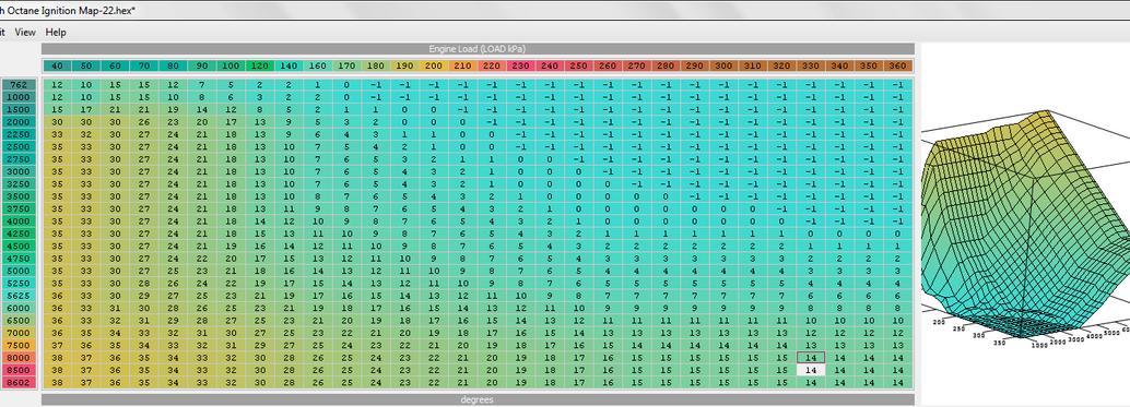

Im gonna try this, adds some mid range timing.
Some of that knocking that I pulled timing for might have been my damned bov leaking. fixed that so i can probably get away with adding some back in.

Looks like you're still just doing a third gear pull from low rpm to high?
If so, try datalogging it starting in first from a stop and running it through 1,2, and 3. Then use that to tune. I think you'll find it will wake your car up.
Big cam/turbo cars are hard to dial in with just a 3rd gear pull because of how different it works it's way through the map vs real world driving.

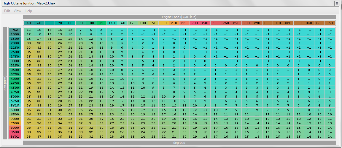

You don't want to run the engine too hard in the spool area. It will cause the high rpm area to suffer.
Use 2 or 3 degrees in your peak load point logging real life acceleration, not just a 3rd gear pull, then add timing from that point through the map trace gradually until redline. After changes, log your 3rd gear pull, and see if it benefited. Rinse and repeat.

nightalker have you any VD standalone runs for your timing map? Curious to see your torque curve!
Also, Ive been relatively knock free for a few days, and since I got here Ive been able to add timing in areas that you guys are suggesting. Up until then I was just pulling and pulling timing like crazy along with my hair. Ive got more sweeping to do.. but this is pretty drastic just to the point where I was on the last page of this thread, or even the top of this page!!!
