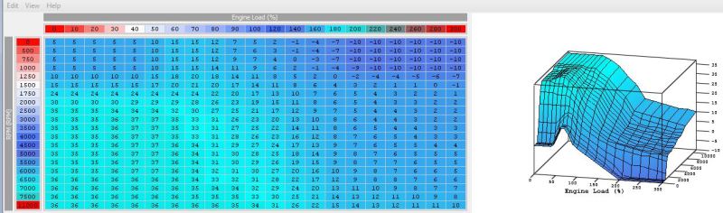

Hi, here is my current Maps with
GT3076R
S2 cams
2.0L
1.5 bar of boost
RON95 fuel
Is there anyway i could improve my lower end torque in order to get my ride response better?
Getting regular 1~2 counts of knock on 2500~3300rpm & 5000~5700rpm.
Thanks

it has all the signs of a half assed tune. take a lkok at the 3d view, and youll see the problem. timing values should only increase when going down the column (up in rpm), and it should be smooth. the more choppy and non sensical the cell to cell change is the worse the car will drive and the more knock you can induce.
i picked up 20whp, tons of driveability and removed a huge knock trait my car had just by smoothing the original "tune" that was on the car.
take a look at my columns

not my most recent fuel map, but you get the idea. the fuel map will be completely individual to every car since the numbers in the map are arbitrary, so you just need to put whatever numbers in that get you what you want.
do you have cams or not? cams will i believe take less timing at peak torque and more out the top...i have never played with them tho, i have a fully stock longblock.
your timing will also vary from what you see in my because i have a 9 and mivec.

holy **** his tune is tore the hell up.
Have you seen a fuel map or timing map when it has the wrong address or scaling?
yea, all his major maps are like that.
His low octane timing map has 10* higher values in it than the high octane map
