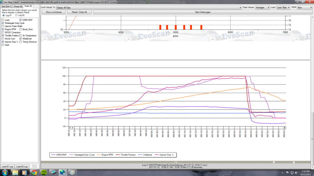

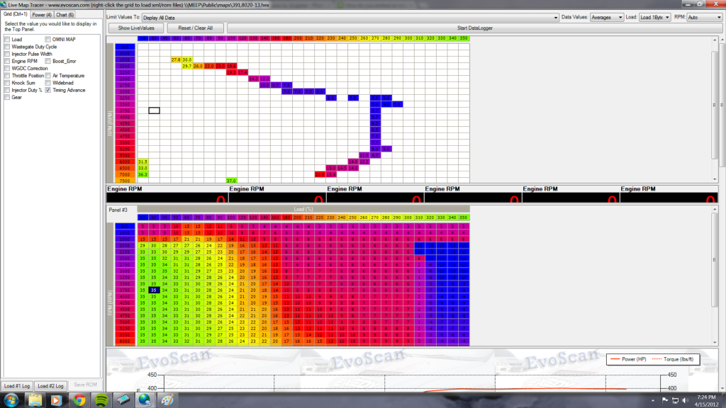

Now that the snow is mostly gone from the roads I started working on my tune again. I still seem to get some tip in knock at around 60-80 load but other than that only a couple random counts over a series of pulls.
What do you think of my afr's and timing during spool, should I be doing something different to try and get the turbo to spool quicker? I running about as much as I can at max power. Boost is 26psi peak and tapering to about 23, the afrs listed below are the actual wideband readings I use meth/water injection so they can be a little leaner. Although my base fuel is only 90oct so needless to say it sucks ***.

your AFR and timing look great.
I honestly wouldnt worry about that knock at 60-80 load unless its like 16 counts or something crazy
That tip in knock can also be from the MIVEC solenoid

thanks for the reply, the most knock I recall seeing for tip in was 4 counts. I was starting to think it was false knock because I had taken a few * out and it was still showing up.
Should I be using less fuel and more timing up to 220 load, my actual fuel target map is all over the place from tuning with the methanol and 12-12.2 (actual afr) was just kind of where it ended up since I had to initially guess how much more fuel the methanol would change it. But the car feels like it runs very strong as is.
Is it better to stay leaner during spool and if so how much for how long?

Your fuel is good. I would actually drop the AFR to the 11 range once you get past 200 load, just for safetys sake.
