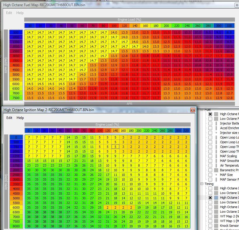

here are mine...

22* up top with meth on a IX?
Must be some strong meth...

50/50 mix
heet and distilled water...
i had her on the dyno, kept giving it to her until she didnt want it anymore... 22 is where she tapped out, well, 24 is where she tapped out, i backed it down 2 degrees just to be on the safe side... and then a few more above 7000.

How much boost at 6500-7k?
