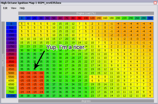

Old Nov 21, 2007 | 05:19 AM
TouringBubble's Avatar
Posts: 2,639
From: Chelsea, AL
Here is my current winter map ...
EDIT :: 93 oct, IX
Honestly guys, I've wanted a car that shot flames for years so I simply had to do it. It's also a nice intimidation method at the track.
(yes, I know that timing only goes to -10)
Old Nov 21, 2007 | 05:23 AM
inco9nito99's Avatar
iTrader: (90)
Joined: Jul 2005
Posts: 1,917
From: Roselle, IL
^^ lol that made me chuckle. how much boost are you building with the 6-8degree block?
Old Nov 21, 2007 | 05:47 AM
Posts: 2,639
From: Chelsea, AL
It was at 6-7-8 and I was building about 12 psi on the line. It's probably closer to 9.5 or 10 psi with 6-8-8 ... I honestly haven't checked. I changed it last time at the track to reduce wheel spin.

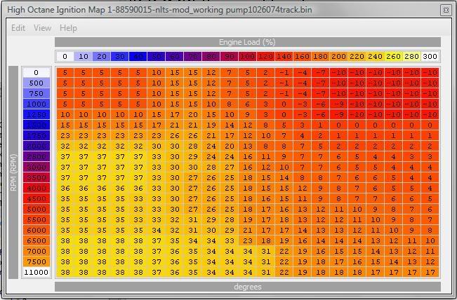

Old Nov 21, 2007 | 07:23 AM
Nuked's Avatar
Joined: Dec 2005
Posts: 374
From: Morgantown, WV
My pump gas timing map.
SQ
EDIT :: 93 oct, IX
I have played around with something similar. Never had a map sensor to get good data, but it seemed like it held boost between shifts a lil better. Downside is it gets a lil annoying on the ears after awhile! haha
SQ
yeah right? not sure if its just New England Dragway's terrible track prep - or maybe my crappy tires? but i don't know how some of you want more boost off the two step - i just spin and spin and spin... my best 60' is 1.8
also TouringBubble: you rule for admitting your a ricer. i find it hard to believe there isn't a little ricer in all of us who drive this car.
Old Nov 21, 2007 | 07:37 AM
Posts: 2,639
From: Chelsea, AL
I pull low 1.7's feathering 1st, but I've landed a 1.62 when it actually hooked. I've got the benefit of track temps down here, but it's a trade off for the insane humidity.
And it would be silly for me to try to make excuses for that retarded timing on lift off. I didn't do it to hold boost on shifts (I'm using the NLTS mod) ... all it does is shoot flames. And it is AWESOME.
Old Nov 21, 2007 | 08:53 AM
esevo's Avatar
Posts: 759
From: Tucson AZ
Any side effects from the flames? any knocks?
