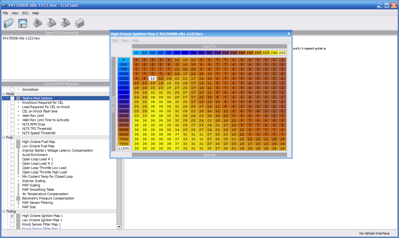

25-26psi peak on 93 plus WI.
lol mspaint sucks. you cant even see my fuel map.
Attached Thumbnails Let's see your fully tuned timing maps-timing-medium-.jpg

Well once you through meth/alchy injection into the mix you almost have to advance timing or at a minimum run super lean. Many variables will change with inj simply due to nozzle size, pump pressure, flow rate, nozzle location, boost level, ect.....

guys save as PNG - jpg artifacts too much

The 4-6 cells for the 2 step cause knock like crazy... I'm gonna have to play with this
