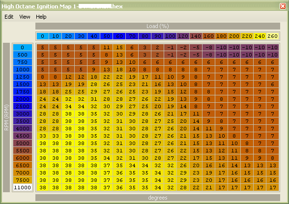

mods are 3" tbe, walbro hpf255, Jdm Bov, Ams frontmount with lower piping, k&n drop in, greddy profec b, Act hdss with prolite flywheel,
what do you guys think?
91 octane and 21 psi

From: Atlanta, GA
^^ thats a huge block of 7s...this your own map from scratch? Or one you had done and are now fixing up?
I agree...
There's some more power to be made in that timing map for sure... I'm scratching my head trying to figure out why the apparent love for the number 7 shows up in that map...

From: On the track
^ If he were to trace a full throttle pull I doubt the 7s would be used much. It just looks overly blocked. In action I'm sure its just fine.

From: El Paso, Tx
im learning hahah!!! anyone have any suggesttions on improving?

From: Indiana
Panda, I am new to the ECU tuning. I would suggest doing some pulls and logging the info. Set out you load cell and rpm and see where your at on the AFR's. Also as for timing see where it loads at and if no knock add a degree in the area of load.
Anyone that is a guru chime in and tell me if this is wrong. Pretty sure this is the right way to approach tuning though.
