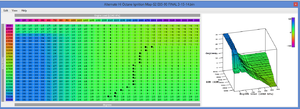

This isn't "fully tuned", but just looking for some feedback on a new basemap.
VIII w/ stock motor, stock cams, walbro, injectors, ets piping, SD, hta 71, 3" tbe, ex mani, planning for 23-24psi w/ a 3 port, 91 oct.
Im considering scaling it back up to at least 320
