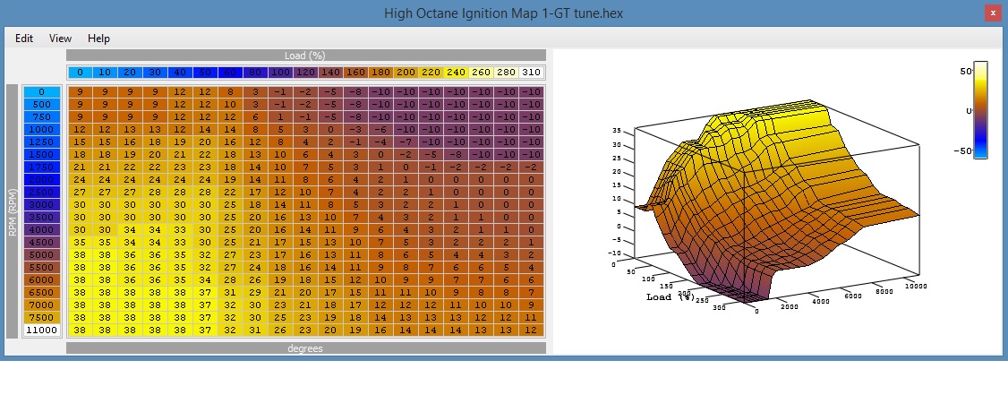

Hey guys, I’m new to tuning so let me know what you think.
Mods: 05 Evo 8 SSL, BBK Full ported, S1 cams, tbe with high flow cat, 3.5” fmic, licp, 850cc injectors, walbro 255, 93 oct pump gas.
3rd gear, hits 275 peak load by 3650rpm. 25.5psi peak boost tapering to about 22 by redline. Peak tq at 5500rpm. 5* at peak tq, 12* by 7200rpm. AFRs are high 12s spoolup tapering to 11.0 by redline.
1 or 2 counts of knock in 3500-5k range, some runs are 0 knock.
Best so far was 433/366 VD. Outside temps 43F. Sorry I don’t have boost or afr plot yet, working on that.
Car runs great and pulls hard, but I welcome any feedback. Thanks
Attached Thumbnails Let's see your fully tuned timing maps-timing-map.jpg   Let's see your fully tuned timing maps-fuel-map.jpg   Let's see your fully tuned timing maps-43f_11.0afr_93oct_433hp-366tq_25.5psi.jpg
Not too bad but timing could definitely use some smoothing out.
We have very similar setups but i'm on the stock turbo. My map is similar to yours but I run about 4* at peak and 11* up top. I just had Ivey install a ported a buschur manifold and wow I can feel the difference already. I"m also in Central NJ if you want to compare notes. I need to retune after the manifold install because I'm running a little leaner above 3500 RPM's.

Thanks for checking it Ian, any specific areas of the map you would suggest?
Thanks Ronaldo, I'm also debating on porting the stock mani or going with a tubular, while porting the IM and tb.
This thread has helped me a ton. Thanks all
