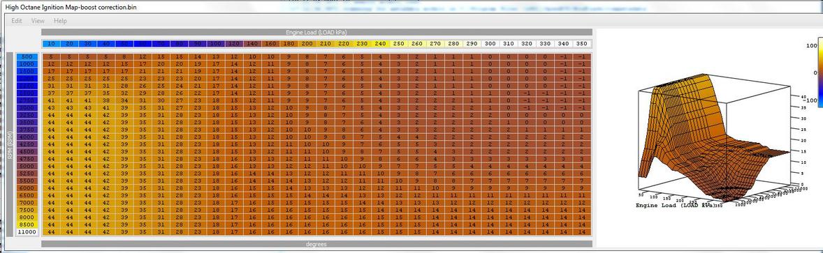

Hi, here's mine.
I often get 1-2 knock when I goes from nothing to full throttle and boost.
I was wondering if it might be because my transfer from like 100load to 300load(25psi) is to much drastic and that cause my knock sometimes...
What do you think of the map??

Originally Posted by PL_MR
Hi, here's mine.
Attachment 210870
Kinda high cruise timing, I hope you don't have EGR advance activated.
Kinda harsh from 60 to 160 load, like you said maybe smooth that a little bit.
Other than that it looks good for 93 octane.
Hi, here's mine.
Attachment 210870
Thats a good map for 25psi. I would run less cruise timing (37-38) and run a little bit more timing from 100-160/180.
Also what are you registering for knock voltage? Sometimes the knock sensor has to be adjusted once the car is modded.
