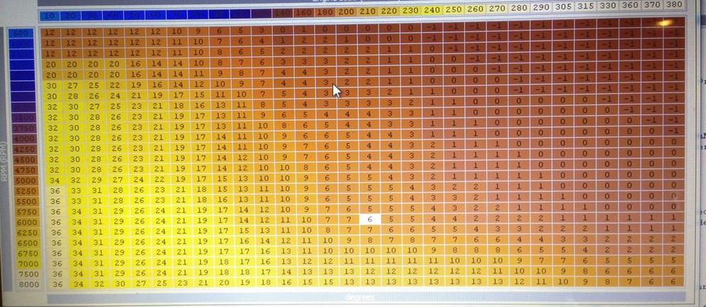

First, we're not "naysayers" or anything like this, we just want to discuss, help, understand, and learn at the same time. That's the purpose of this thread.
Now back to the subject:
That why I told you it's mild in the first place. Something is happening if you can't run more than that. You are running 0* from 4000 to 5500RPM and 1* up to 6krpm. Maybe that's what you specific setup/car wants, but it's new to me.
3rd-4th gear which cells do you hit in that map?
Map you posted:
Old Aug 27, 2013 | 09:48 PM
  #2420
01sporty's Avatar
Joined: Dec 2010
Posts: 151
From: salt lake city utah
Lol I was just messing with ya ya it is mild but it won't take any more timing. This fuel around here sucks!!!!! If I run even 2* it just starts pulling 1* back anyways so why not just circumvent the ecu retarding timing all together. What most people don't realize is a 7blade hx is a 60+ lb/min turbo and on straight 91octane no meth no additives it just limits you pretty bad. And the logs I have been looking at today show a target of 2* actual 2* and climbing from there. It makes good power on 91 but it is being switched to a more stable fuel this week
Map you posted:
Peak boost(30.6psi now) =310 load
At 5k it is down to 295
By redline(8000rpm) 260 load
Old Aug 27, 2013 | 10:12 PM

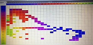

Ok I just went searching through the 500 logs in my computer and her is a 3rd-4th pull at 29psi 8* at 7000 rpm and by 8000 it's 12.5-13 actual
Old Aug 27, 2013 | 10:15 PM
  #2423
01sporty's Avatar
Joined: Dec 2010
Posts: 151
There was a 2count which took 1* at 6900 but a subsequent run showed no knock someone earlier asked what cams I have and I have comp 280's with Gsc beehives. I am looking to upgrade my cams to either Gsc s2 274/274 or kelford hi lift 280/276
I'd say it's still full boost at 5.5krpm. Either it's not a 3rd gear run like in your video, or you aren't going WOT at low RPM enough to hit the 4k to 5.5k cells at full boost (the oddly low timing cells)
Old Aug 28, 2013 | 12:25 PM
  #2425
01sporty's Avatar
Joined: Dec 2010
Posts: 151
i am going wot at 5k on the freeway after scanning for the mexican federales that particular log is one I remember well. I was having some transitional knock that day that I was trying to figure out. Had to adjust the map ve settigns under boost I was like 18-20 psi would=170-180 load and I was dipping too far into timing advance. so ya its not perfect but it has ran a best of 11.89@121 so it must be making good power on 91octane
