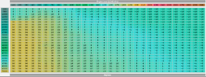

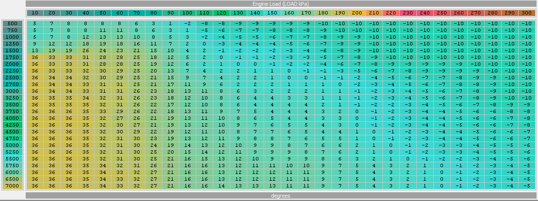

wats up guys.. so im learing how to tune.. been reading and reading and now starting to put the knowledge to work.. now this is my tune.. on 93 oct., started with 18psi and will move up from there.. but did 18psi, afr starts at 12.5 12.0 for boost build up and tapers to 11.8 11.5 by mid and 11.0 by top end.. with no knock.. all my mods are on my sig.. now like i said this is my first attempt so be easy on me lol.. just wana learn and wana get opions.. only way to learn is to ask questions thanks..

Lots of things to work on bud. First and foremost, get rid of that block of -10s in the middle of your map unless your trying to break something. Try to keep the difference from cell to cell no more than 3. Timing should decrease as you go across the load columns (left to right) and increase as you go through the RPMs (top to bottom). Timing at peak torque could be anywhere from 3-7 and then increase from there to about 13-18 at redline (7000). Different cars and setups will take different amounts of timing so start low and then increase until you start to get knock. Then back off a degree or two.

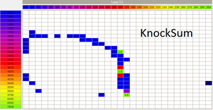

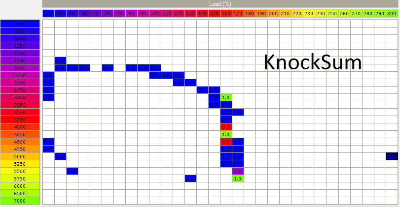

I'd like your opinions.
Please feel free to PM me on this, or reply here if that's the procedure. Please note...
My engine is a 4g94, so timing shifts roughly 100 -> 120 and maybe... 160 -> 220 as far as lancer timing -> evo timing.
This is roughly...8 or 9 psi.
Attached Thumbnails Let's see your fully tuned timing maps-timingmap.png   Let's see your fully tuned timing maps-knocksum.png   Let's see your fully tuned timing maps-dynooz.jpg

Thanks For the info.. That -10 block is for the 2 step.. But I guess I heard wrong on doin that lol.. Ill get rid of that asap.. And I get wat you mean about the timing.. If I get rid of that -10 block would that affect my 2 step at all?..
You can get Tephra v7 with launch maps, then it's a separate timing map for that.

I noticed and forgot to post.. At 3100 to 3180 I get 1 count of knock.. At 116 load.. You think that is sumthing I should worry about?..

I see your reasoning but I think it's dangerous to do it that way, especially with running that much negative timing. Like the other guy said, I definitely suggest going to Tephra V7 if you're looking for some launch control.

I wouldn't worry about it. It's probably false knock anyway.

Yeah you'll be fine to 2-step, that's how I'm doing right now. The reason to run that much negative timing in a launch map is to help build boost during the 2-step. I've heard some say it helps a lot but I've never tried it before. I'm building 9-10psi in my 2-step without using launch maps right now.
