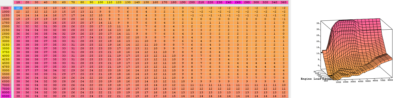

Originally Posted by Jonesey I7
Well......... worked on mine some.... whatcha think?
6k rpm and beyond needs some work between 100 and 200 load. Don't have jumps of more than 3 degrees per 10 load units.
May as well throw up my current timing map at the same time. 91 octane, 22-23 psi peak tapering to 19.5-20 at 7k.

What Raptord said. You need go smooth the timing map out. A big jump in timing can cause knock.

Thanks guys, my map was smoother. But those two cells never come together on the pulls or driving and I have zero knock. BUT none the less, I'm gonna go make a baby between my current map and the one you just posted Raptord, as I follow some of your posts and believe very much that you know what you're doing more than me.
*edit* Feel like I'm strung out on drugs from sleep deprivation... but I'm done.
Worked it out for you Rap..... better?
Bottom map is for 28psi, Top is for 24psi

Looks much better Jonesey.

I actually got sick of all the bs I was having with V7, and with some advice from a friend....FINALLY finished switching back to V5.10
here they are, done
Opinions? Raptord approval?
Raptord approval?
map looks pretty good. Could possibly use a bit of smoothing between 120 and 140 load around 3k rpm on the timing map and there a a few big drops in the fuel map (2k -> 2500 mainly), but besides that, yes, you get the Raptord seal of approval:
