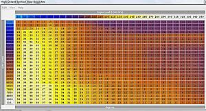

Heres mine last messed with it in September.
Mods in sig, on 93. 24psi.

It needs some cleaning up

I'm still learning lol.

His map definitely needs a lot of work.

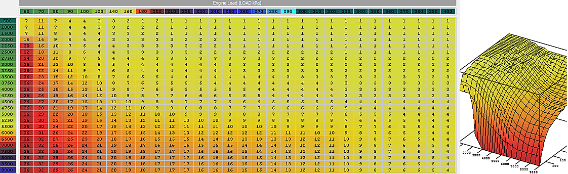

I try to enter logical and conservative numbers in the areas that even you dont hit at low load high rpm, and areas you would hit if the boost were starting to increase a little beyond normal. in my case being SD my load is a little different than others, but I have 50 load head room beyond my max boost ~32 psi

How does the overall smoothness/trends look for my map that I posted above? I have hks272, o2 dump, tbe catless, hta71, 3dsd, peaks at 350% drops to about 275% or 14* timing. 3* peak, 93 oct My timing map is tested to 390 load or something like ~30ish maybe a touch more.
