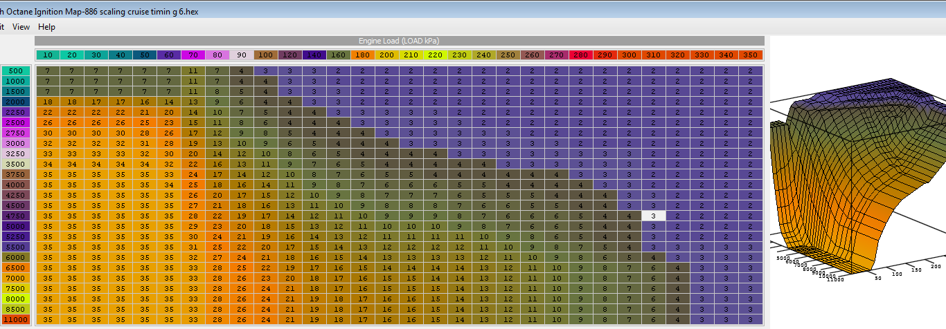

well im about done for now.
smoothed the top a tad since this screen grab. running 4* at peak torque and 17* at 7200, 37* at cruise for easy passing while staying in vacuum (nice 25mpg with a bad front o2). Occasional 1 count of knock, car consistently makes 330/300 on VD on peak of 24psi.
according to my wideband im running 11.9ish afr, more than likely a tad off though. got the idc's up to 102 and couldnt dropt it any. time for 1050's, a fuel pump and o2 housing and up the boost.
quick question, what fuel are you running with this map?
93 pump, do you think something looks good/bad?
im also at a max elevation of like 200 feet above sea level, and i see your in colorado.
no, it looks great. i was just wondering for comparison to my own map. im trying to find how high i should push my timing in the high rpms.
im running 91, but my 6000 ft altitude allows me to run a little more aggressive timing than 91 at sea level, but i do travel to sea level, so im trying to find a map that is safe at sea level too.
the only thing is that my car is very resistant to knock. it ONLY knocks in the 6600-6900 rpm range, but that is regardless of if im running 11* or 18*, it just knocks 2 counts.
this is on stock block, stock turbo, pretty much all the bolt ons. peak 23.5psi tapering to 16 psi
