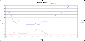

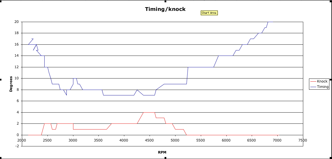

Thats gonna make for one UGLY timing curve and will make the ECU work harder than it has to in that 200 load column. A smooth map minimizes knock issues from the ECU trying to "keep up" basically. You really should have the timing be a smooth transition all the way across, regardless of the pre-meth/post-meth crossover point.
Here's a timing graph from a 2000 to 7200rpm pull. I hadn't really noticed before but you can see the bump at 3000rpm where it hits 200 load. I'll adjust the 200 load column a little. BTW the knock count of 4 at 4500rpm is quite unusual. I have the cel set to flash at 4 and above and it seldon comes on.
Old May 7, 2009 | 04:10 PM
  #507
RoadSpike's Avatar
Joined: Oct 2006
Posts: 3,805
From: Sacramento, CA
Originally Posted by John F
No. It is deliberate. If I'm in that area of the timing map I'm at part throttle, not injecting much meth, just waiting to mash the throttle. This is an area of very quick spool and I've found keeping the timing the same as my standard map in this area reduces the chances of knock on spool. It essentially gives the meth injection time to kick in before the timing gets high. If anything maybe the 200 column should come down a little but it has not been an issue.
Ok that makes some sense, have you experimented with a smoother timing ramp up than the jump as seen in your log?
