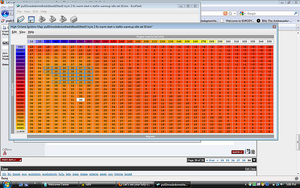

heres my fully tuned/constant work in progress hi oct map
93oct
22lbs @peak tq (3250 ish rpm) creeps to 25psi then 20-22 by red line
i smoothed it out just for neatness sake i have 0 knock . let me know what you think!
edit: im in the 270 load cells @full boost then down to 220 by red line.
Old Feb 18, 2010 | 02:10 PM
  #583
SyZyGy1394's Avatar
Joined: Nov 2006
Posts: 1,441
From: INDIANA FOO!
93oct
Time for a rescale?
Old Feb 18, 2010 | 10:42 PM
  #584
hediki12's Avatar
Joined: May 2009
Posts: 522
From: mnt vernon ny
Originally Posted by SyZyGy1394
Time for a rescale?
Hahaha. Yea I actualy rescalled it this evening. I'm gonna rescale it a little more knock off the 350 and 340 maybe 330. But how does the timing look? I haven't messed with afrs yet I'm just hoping its not 2 agressive since it hasn't knocked yet I'm just gonna keep going.... maybe try a faster ramp speed and see how it affects the VDR. (< awsum tool by the way)
Old Feb 18, 2010 | 11:17 PM
  #585
Appauldd's Avatar
iTrader: (22)
Joined: Nov 2003
Posts: 2,408
From: Northern KY near Cincy
The table looks very smooth....good job. I would recommend stopping with it until you have your fuel in check.
It would be pointless to put hours into making a timing table look great only to have to go back and re-tune it because you have the ability to do so because your fuel is in check.
You have a good start....tune the fuel table and then come back to the timing table.
