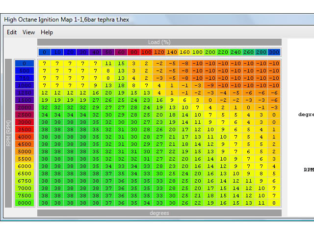

here is my timing map
this one is for a 03 evo 8 with exhaust, air filter, ams licp, walbro fuel pump
and ebc 25 psi on 93 octane
what do you guys think

I feel if we are going to compare Ignition tables more accurately we need:
Turbo Size
Short Mod list (exh, cams, IC)
Boost
Fuel type
Trace of Load cells for a given gear.
A/f couldn't hurt either.
Old Jul 14, 2008 | 05:22 AM
  #385
bigric09's Avatar
iTrader: (37)
Posts: 3,146
From: Spec-Ops Motorsports, Fayetteville, NC
that is a good point... maps change tremendously
Old Jul 14, 2008 | 10:22 AM
  #386
lemmonhead's Avatar
Joined: Nov 2006
Posts: 1,296
From: wexford,pa
agree, otherwise its like comparing figs to sundried raisons or apples and oranges. or like whos line is it anyways where the POINTS JUST DONT MATTER

this is a noob question but why do you guys pull so much timing at low RPMs?
The way how I was thinking about it was you would pull more timing out when the boost kicks in at high load and at higher RPMs.
How much boost can you be making at below 2000 rpms?
Old Jul 15, 2008 | 03:58 AM
  #389
bas_evo's Avatar
Joined: Feb 2008
Posts: 33
From: netherlands
under 2000rpms there's no boost
Old Jul 15, 2008 | 05:04 AM
  #390
bigric09's Avatar
iTrader: (37)
Posts: 3,146
the lower numbers that low are for idle mainly. If you set the #'s too high, you misfire
